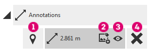

Contextual tools are available for each data type so you can navigate to or edit the element easily.
- Fly to
- Add details
- Toggle visibility
- Delete
