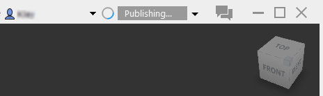

Click Publish in either case to send your files to Autodesk Drive or Autodesk Docs (BIM 360).
Feedback on upload progress is available in the title bar.
