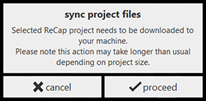

Once an aerial image project is processed, click "Download and open point cloud" in the project thumbnail. This synchronizes the RCP from Autodesk Construction Cloud or Autodesk Drive to use ReCap Pro for further workflows. This tool is disabled when an object reconstruction project is processed as point clouds are not generated for object based projects.
Click this tool to open a dialog to synchronize project files.
Click proceed to synchronize and open the point cloud from Autodesk Drive or Autodesk Construction Cloud in ReCap Pro.
