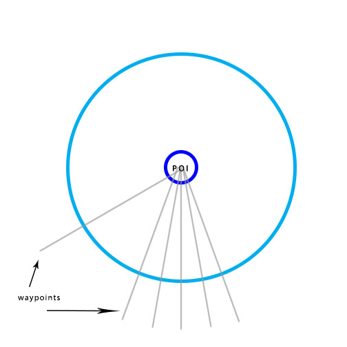

Many ground-based projects (commonly, but not limited to buildings and similar structures) involve a point of interest (POI). This is essentially the midpoint from which to plan your mission and offer the best chance of certifying sufficient overlap of your photos. Typically, a path type, such as "lawnmower", which uses large, straight-lined paths, or similar, is programmed into the UAV. Conventional flight path types can involve large, overlapping orbit patterns using oblique or NADIR positions.
The schematic below reflects a simple circular orbit with a waypoint at every 10°, which would produce 36 photos.
This is an example of a recommended method for many capture cases, and applies very well to simple square or circular structures, such as buildings; essentially, normally shaped structures with a close 1W:1L ratio. Other areas, such as football fields or other large areas, tend to be mapped under a lawnmower-style UAV flight pattern.

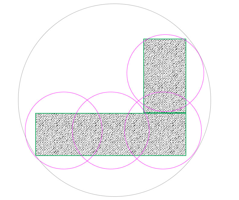

Alternately shaped objects might require additional orbits in order to gather the scene. This might involve adding some additional radii or elevations to the flight program.
