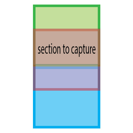

3D reconstruction of your scene is best when each section is shot from at least 3 different perspectives. Capturing successive images with a minimum 60% overlap can often produce acceptable results, often including a minimum 20% orthogonal overlap. This overlap ensures accuracy and is necessary for ReCap's Photo-to-3D and manual stitching services. Evaluate your scene while noting less-defined areas, such as sandy areas or thin, wiry objects (such as poles or fences) as these areas or specific elements might benefit from a higher overlap percentage.
Reconstruction of your scene requires each feature to be shot in at least 3 different perspectives to ensure a minimum 60% overall overlap, including a minimum 20% orthogonal overlap. This overlap ensures accuracy and is necessary for ReCap's Photo-to-3D and manual stitching services. Less-defined areas, such as sandy areas or thin, wiry objects such as poles or fences, might benefit from a higher overlap. See an example of an acceptable overlap below:
If there are difficult areas you intend to capture, you might need to seek alternate viewpoints and/or use manual capture methods to secure those parts of your scene.
Too little or too much overlap can produce lesser-quality reconstruction results. Not enough overlap does not allow your project to stitch properly and hold a general poor quality. Too much overlap (>80%) is usually considered redundant, as more than 3 perspectives of a point has not been shown to benefit most projects, and might successively require you to disburse the time to delete excessive images.
