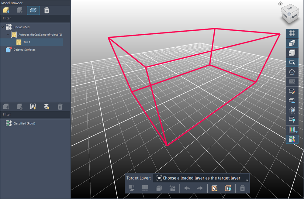

To view a model, including classification layers in the Mesh Editor, you need to load the model.
Select one or multiple models  in the Model Browser and click  Load from either the toolbar or the right click menu.
Tip: Do not load too many models into a view at once as this can cause performance issues. For large data with many mesh tiles, consider working with only a few tiles at a time and use classification groups to help manage the project.
You can toggle the visibility of loaded models by clicking the  visibility icon next to each model in the model browser. Models set to  hidden will still be loaded, but will not be visible or selectable.
To unload a model from view, select one or multiple models in the model browser and click  Close.
To load unclassified mesh tiles by their extents in the model view. Click  Tile Selection. Click on a tile to select it and then click Load. This helps to work with data containing multiple tiles. Click  Tile Selection again to return to 3D selection.
