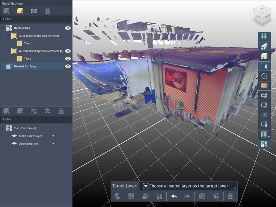

Deleted surfaces can be loaded to help recover from any mistakes that may have occurred. For example, removing an object that was accidentally included in a selection and deleted.
Click  to load the Deleted Surfaces layer which is found in the Unclassified section of the Model Browser.
Deleted Surfaces will appear in the model view displaying a red hatching. These surfaces can be selected in the usual way. To remove a surface from the deleted layer, set the desired target layer and click Classify.
Once loaded, you can hide or show the Deleted Surfaces using the  and  tools.
The deleted surfaces layer can be unloaded by clicking  .
