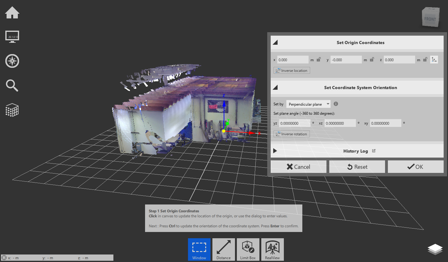

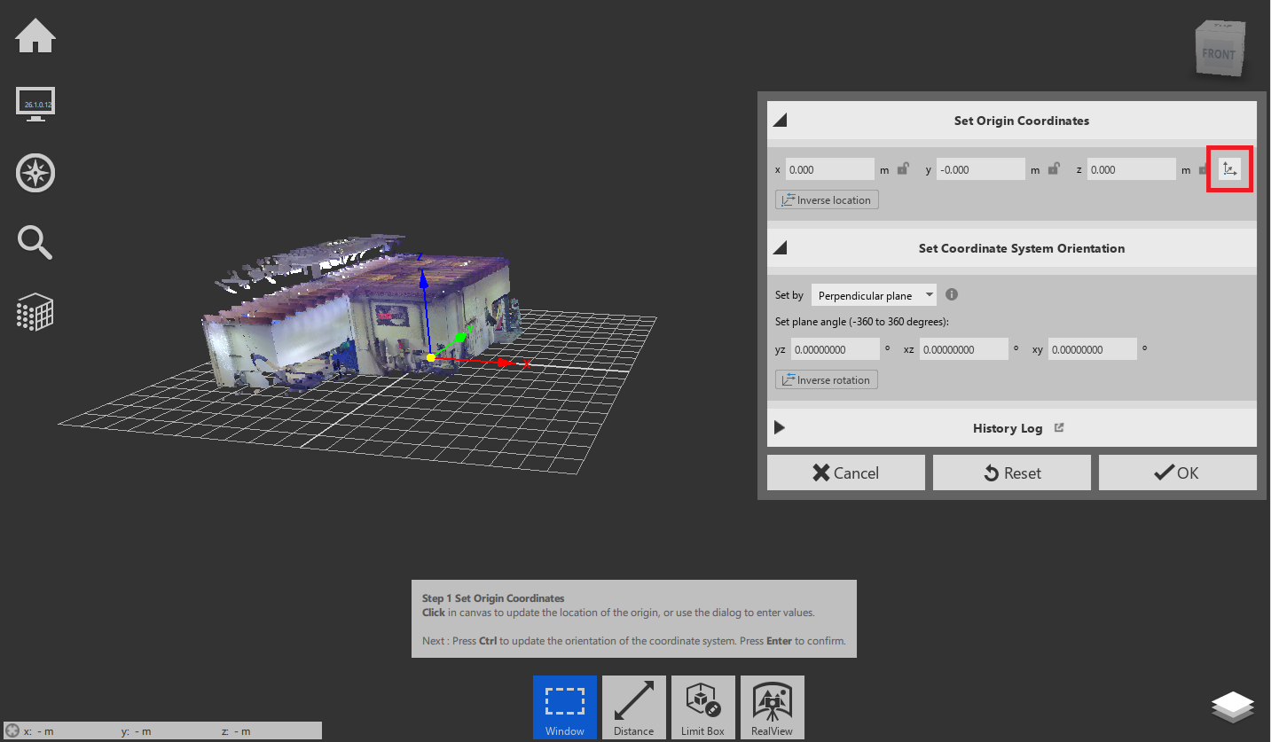

A new “Zoom to Origin” button has been added to the Update Origin Tool, allowing you to instantly focus the camera on the origin point. This is especially helpful when working with large point clouds or after navigating away from the origin.
What It Does
  • Centers the origin (gimbal) in the middle of the canvas.
  • Works with both small and large coordinates.
  • Helps you quickly re-orient after making changes or navigating the scene.
How to Use
  1. Open the Update Origin Tool.
  2. Make any changes to position or rotation if needed.
  3. Click the “Zoom to Origin” button.
  4. The view will immediately center on the gimbal.
Good to Know
  • Works even with large or negative coordinates.
  • Remains functional after tool switching, ViewCube interactions, or long sessions.
  • ViewCube and mouse navigation work seamlessly post-zoom.
  • If invalid inputs are present, zoom is safely ignored to avoid disruptions.
  • Compatible with all major modes and reset/orientation scenarios.
  • If camera is too close/far from the gimbal, or if gimbal is located behind the camera - it zooms to default distance keeping the same camera angle.
  • If camera is located between the minimal and maximal distance to gimbal - it just moves gimbal to the center of the screen keeping the same camera angle and distance.
