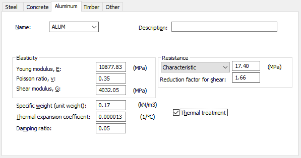

Select Materials in the Job Preferences dialog and click the Modification button. Select the Aluminum tab to access the following parameters.
Define the following:
Name
The representative name of the defined aluminum.
Note: The material name must be assigned before the Add button is pressed.
Description
The representative description of the defined aluminum.
Elasticity
  • Youngs modulus - the Young's modulus value for the defined aluminum.
  • Poisson ratio - the Poisson's ratio for the defined aluminum.
  • Shear modulus - the shear modulus for the defined aluminum. This recognizes the influence of shear forces on structure deformation.
Resistance
  • Characteristic / design resistance - the characteristic or design resistance values of the defined aluminum.
  • Reduction factor for shear - the shear coefficient for the defined aluminum.
    Note: The shear coefficient is used during structure calculations when shear deformation calculations are required.
Others
  • Force density (unit weight) - the density (unit weight) of the defined aluminum.
  • Thermal expansion coefficient - the thermal expansion coefficient for the defined aluminum.
  • Damping ratio - the damping ratio of the defined aluminum.
