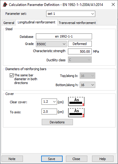

The Longitudinal reinforcement tab allows you to define the parameters of longitudinal reinforcement of an RC member according to the Eurocode 2 (EN 1992-1-1:2004/A1:2014 with different National Annexes).
Access
  • Click Design Required Reinforcement of Beams/Columns - Options Calculation Parameters to open the Calculation Parameters dialog, and then click .
  • Click (RC Member calculation parameters) to open the Calculation Parameters dialog, and then click .
Dialog elements
Steel
Select the grade of the defined steel.
Diameters of reinforcing bars
Defines the diameters of bars for reinforcement of an element.
The bars are listed in metric diameter units for top/bottom reinforcement. Bar diameters can be different for top and bottom reinforcement of a beam. Similarly, a column can have reinforcement along h and b sides.
If the same diameters are used for the entire element then The same bar diameter in both directions option should be selected.
Cover
Defines the cover values.
The cover can be calculated as a cover to axis or clear cover of bottom reinforcement. Cover values are converted automatically.
Click Deviations to specify values of deviations of the cover.
