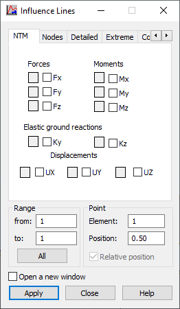

    After the NTM tab is selected in the Influence line dialog, the following displays.
    The options in the dialog let you indicate the resultant quantity for which the influence lines are presented:
    • Forces- In the local coordinate system FX, FY, and FZ
    • Moments- In the local coordinate system MX, MY, and MZ
    • Displacement- In the local coordinate system UX, UY, and UZ
