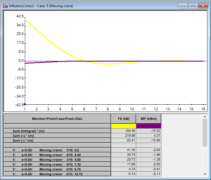

Example of an influence line
The influence line can be divided into 2 section:
  • Table displaying the numerical results of calculations; the following data is presented in the order of listing:
    The top of the table for moving load analysis specifies a value of the integral for the diagrams displayed in the view. The values of the following integrals are given:
    • Total sum
    • Integral of the positive and negative parts of each diagram
    Remember that an integral value depends on the selected length unit, because the integral value is expressed in the unit as a product of the unit of the quantity in the diagram and the unit of the route length.
    First column - The number of the bar (element) for which the influence line is created, the point position on the bar (element), the name of the moving load case, the position of the moving load, and the position of the moving load for its successive positions over the structure.
    Two or three columns (depending on the structure type) - Coordinates of the vehicle position in the global coordinate system.
    Further columns The values of the selected quantities for which the influence line is created.
  • Diagrams of the influence lines of the selected quantities.
