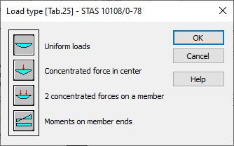

The dialog box below enables definition of a load pattern for the analyzed beam.
The information about the loading method is used in calculation of a value of the ξ coefficient (Table 25), which in turn is applied to determine the slenderness of a member due to lateral buckling (7.2.3), and next, the lateral buckling coefficient according to Tables 43-64.
