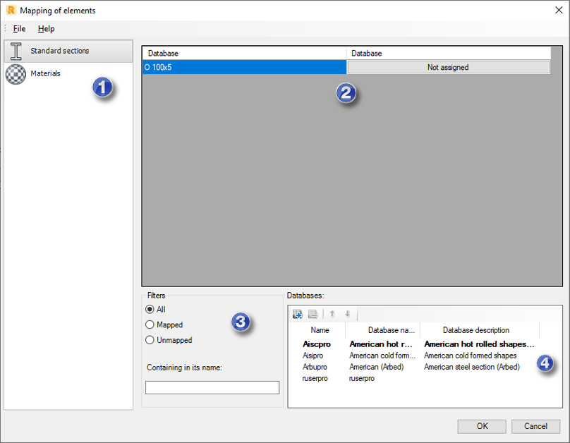

Use Mapping of elements dialog to manually assign materials and sections from Advance Steel databases to materials and sections in Robot databases.
1. Tabs
These tabs contain lists of sections and materials that were not assigned automatically during the transfer.
2. List of unassigned sections or materials
Depending on the tab, list of sections or list of materials that you need to assign to sections or materials from Robot databases.
3. Filters
While mapping elements, you can use these filters:
  • All - Displays sections or materials that you assigned and those not assigned yet.
  • Mapped - Displays sections or materials that you assigned.
  • Unmapped - Displays sections or materials that remain to be assigned.
  • Containing in its name - Displays sections or materials whose names contain a character string that you enter.
4. Databases
The list includes the databases set for your Robot project, in the same order as in the Job Preferences dialog.
To work with databases, use the following icons:
  • Add a selected database to the list.
  • Delete a selected database from the list.
  • Change order of viewing the databases (move one position up/down).
