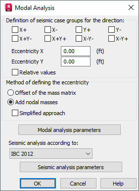

Click Modal with automatic definition of seismic cases in the New Case Definition dialog where a direction and a value of eccentricities can be specified.

Two methods to define eccentricity are available in the program:
  • Offset of the mass matrix: modifies masses matrix elements considering shift of the mass by the indicated distance; only the consistent mass matrix is available for this method
  • Add nodal masses considers additional nodal masses which model shift of the mass; all types of mass matrixes are available for this method.

To facilitate large numbers of cases and seismic combinations, the following two methods are available:
  • Automatic generation of a set of modal analysis cases with an eccentricity and accompanying seismic analysis cases and their combinations. This does not change the way calculations have been performed so far, it only automatically creates all cases.
  • Simplified approach taking account of the mass eccentricity in the seismic analysis without the need to shift the mass in the modal analysis. This requires solving the modal analysis one time and significantly reduces the calculation time. The method for considering torsion of a structure implements a modification of pseudostatic forces directly in the seismic analysis, without a modification of the mass matrix.
Note: These methods are independent and mutually excluding. In the first method the mass shift is considered in the modal analysis, while in the second, the eccentricity is applied in the seismic analysis.
There are also two buttons for opening additional dialogs. In these, parameters of the modal analysis and selected seismic code can be specified. In the modal and seismic analysis parameters the definition of a mass eccentricity should not be set because it will automatically set during the generation of cases.
