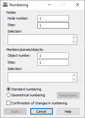

Open the Numbering dialog, which lets you define numbers for nodes, members, panels, and object, using either method:
- Click Geometry menu > Numbering.

The dialog box is divided into 2 parts: Nodes and Members/Panels/Objects:
Nodes field |
Members/Panels/Objects field |
Node number - Specifies the new number of the first node. |
Object number - Specifies the new number for the first member, panel, or object. |
Step - Specifies the value used for the step when numbering nodes. |
Step - Specifies the step value for numbering members, panels, or objects (such as, arcs, circles, etc.). |
Selection - List of nodes whose numbers will be changed. New node numbering is defined by two parameters: the number of the first node and the numbering step. |
Selection - List of objects (members, panels, arcs, and so on) whose numbers will be changed. New object numbering is defined by two parameters: the number of the first object and the numbering step. |
The Members/Panels/Objects field lets you change the numbering for members, panels, or objects (arcs, circles, polylines).
There are 2 ways for changing the numbering of a structure elements:
- Standard numbering - Default option
- Geometrical numbering - Clicking Parameters opens the dialog where you can specify the parameters for geometrical numbering.
At the bottom of the dialog is the Confirmation of Changes in Numbering option. When selected, a change in the numbering of members, nodes, panels or objects is signaled by a warning message.
