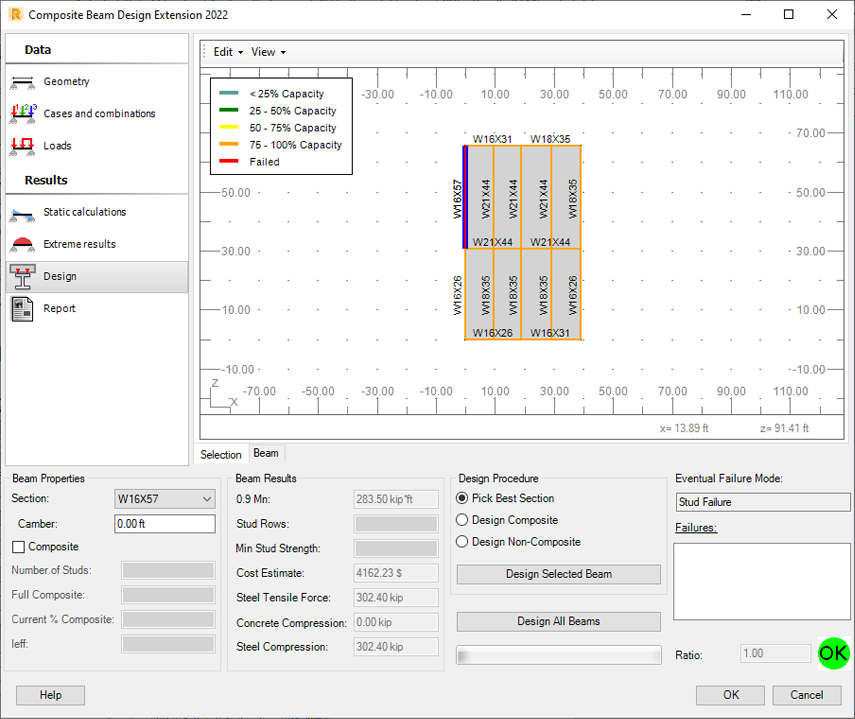

Check and design the behavior of composite steel beams according to the ANSI/AISC 360-10 code.
Use the Design tab to specify the following design settings:
- Section
To check the beam behavior, you can select different sections from the Section list. They are verified instantly:
indicates that a section does not fulfill the ANSI/AISC 360-10 design requirements. The Failures field displays information about the incorrect beam parameters. Select another section.
indicates that a section fulfills the ANSI/AISC 360-10 design requirements.

- Design procedures. Use them to select the optimal section.
- Pick Best Section. Depending on the beam behavior, it uses one of the remaining procedures: Design Composite or Design Non-Composite. See Design Assumptions.
- Design Composite. It treats the section as a T-beam (steel beam composed with an RC slab). You can use this procedure for beams that can be designed as composite. See Design Assumptions.
- Design Non-Composite. It treats the section as a steel beam section only. The RC slab is not included in the calculations.
- Design options. To start the design, click one of the following:
- Design Selected Beam. It automatically selects the optimum section, number of studs, and camber for the beam selected in the graphic viewer.
- Design All Beams. It automatically selects the optimum section, number of studs, and camber for all selected beams based on the internal forces resulting from the method of calculating forces you selected.

In addition, the graphic viewer presents studs designed on the beam.
After design is finished, click OK to update the Robot model with changes in section, number of studs, and camber, and close the extension.
