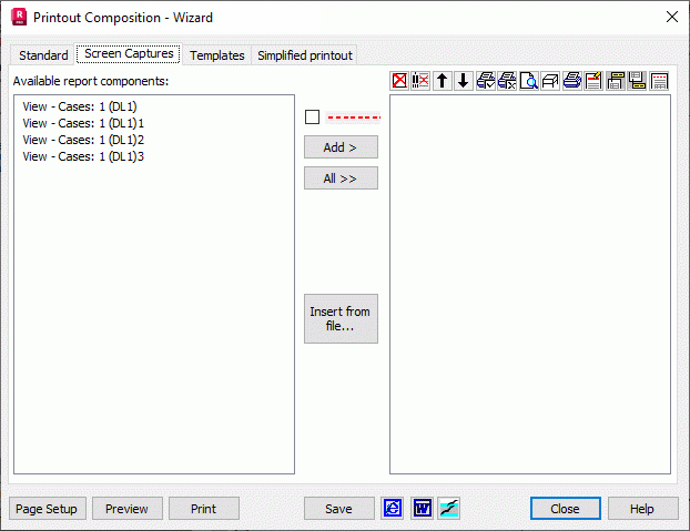

Select the Screen Captures tab in the Printout composition dialog to select options for screen capture printouts.

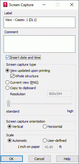

The dialog is divided into left and right panels. The left panel presents screens captured by the user. Screen capture operation may be carried out by selecting File > Screen Capture.

The right panel composes a complete printout that may contain all the objects specified in the left panel. To prepare the printout composition, move screen captures from the left to right panels using the All and Add buttons. All moves all of the available objects to the right. Add moves only selected (highlighted) objects.
Click Insert from file to enable loading any file into the composed printout. *.rtf format files can be loaded as well.
