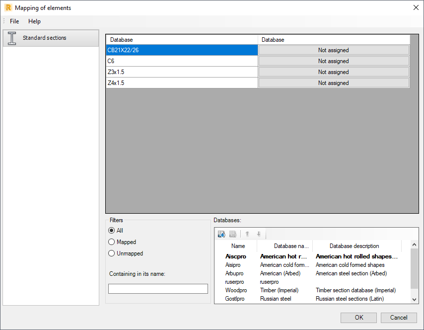

- The
Mapping of elements dialog opens only if, during the transfer, section names (defined in
Revit) are not recognized in the active section database of
Robot.
- Click the
Not assigned button located in the right-hand side of the profile, which was not recognized. The additional dialog opens, where the profile to be assigned from the database is to be selected.
Use the icons to work in the Mapping of elements dialog:
add selected database of profiles to the list.
delete selected database of profiles from the list.
change order of viewing the databases of profiles (one position up/down).
- When you click OK, sections from the database are assigned to the unrecognized sections (they are assigned geometrical properties).
- Click the
