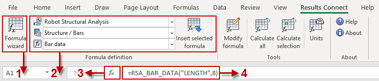

You can define formulas, that allow acquiring information from Autodesk Robot Structural Analysis Professional project, using either of the following ways.
- 1. Formula wizard
- Insert a formula by using Formula wizard dialog.
You can access it from the Ribbon by clicking Results Connect tab
Formula definition panel
Formula wizard.
- 2. Insert selected formula
- provider - specify a provider (program) from which information or results will be downloaded from
- category - specify a category for formulas or select ALL to view an alphabetical list of formulas Note: Formulas are categorized by groups depending on type of information that can be obtained (for example Selection).
- formula - specify a formula (for example List of selected objects).
You can specify the following settings by using selection drop-down list available on the Ribbon:
- After specifying settings above, you can insert the selected formula by using Insert formula dialog.
Insert selected formula.
- 3. Insert function
- Insert a formula with Insert Function dialog.
- Ribbon - by clicking Formulas tab
Function library panel
Insert Function - Formula Bar - by clicking
Insert Function icon.
You can access it from:
- 4. Insert formula manually
- Define a formula by typing a formula syntax manually in the address bar.
. You can find all necessary information about each formula in the Formula list - Robot Structural Analysis and Formula list - Results Connect.
Note: A formula always starts with an equal sign (=) and text defined as an argument must be enclosed in quotation marks.
