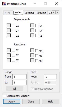

    Nodes
    After the Nodes tab is selected in the Influence line dialog, the following displays.
    The options in the dialog let you indicate the nodal quantity for which the influence lines are presented:
    • Displacementin the global coordinate system - UX, UY, UZ, RX, RY, and RZ
    • Reactionsin the global coordinate system - FX, FY, FZ, MX, MY, and MZ
