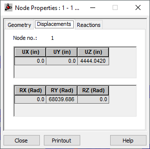

Displacements
Click the Displacements tab in the Bar Properties dialog to display the following:
In addition to the node number, the tab displays the displacement values for the selected node and load case in table format. If the selection has more than one load case, the table displays the extreme values of displacements.
Note: The number of columns in the table of displacements and rotations depends on the number of nodal degrees of freedom for the selected structure type.
Note: This tab is not displayed, if no structure calculations have been performed.
