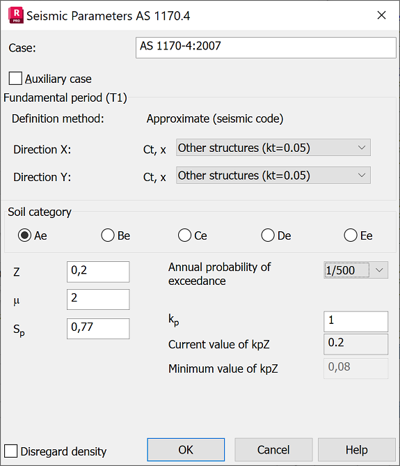

Approximate method
The fundamental period T1 is calculated according to the equation 6.2(7):
T1 = 1.25 * kt * hn 0.75
where:
kt = factor for determining building period (given by the code)
h - structure height (m), defined by difference between Structure range and Reference level

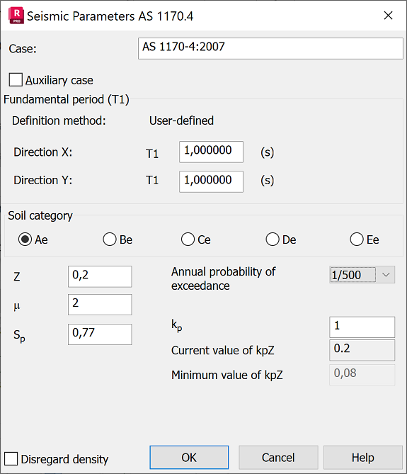

User-defined method
Only T1 on both directions is to be defined.

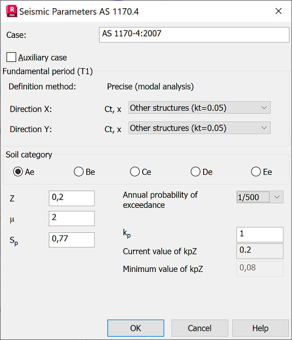

Precise method
According to this method you can calculate the exact value for both X and Y directions. If the option Periods with maximal mass participation is off in the Seismic Analysis dialog, the first mode in direction where more masses is active. If this option is on, one of modes, which fulfill limitations and most masses is active in the direction.
