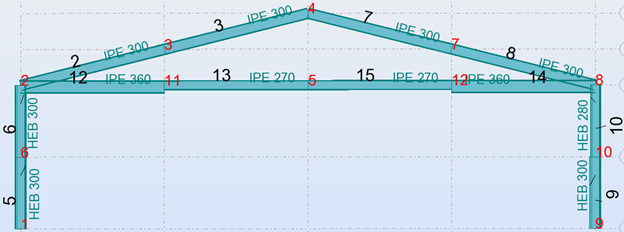

Examples of splice connections in a structure
In a structure such as the one above, the following connections can be found.
Node Bars Type Compatible Connections
3 2, 3
Beam Splice
All types of plates
7 7, 8
Beam Splice
All types of plates
5 13, 15
Beam Splice
All types of plates
11 12, 13
Beam Splice
Web plates, bars offset
12 15, 14
Beam Splice
6 5, 6
Column Splice
All types of plates
10 9, 10
Column Splice
