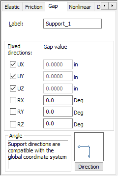

Support with gap
Once the Gap tab is selected from the Support Definition dialog, the following dialog displays.
The definition of support with gap consists in indicating the support name, selecting the fixed or released degrees of freedom and indicating the values of the allowable displacement or rotation for the released directions. If the direction is fixed, the displacement is equal to zero.
Note: The definition of only positive gap values is allowed.
