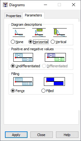

On the Parameters tab of the Diagrams (thin-walled section) dialog, you can select the manner of presenting diagrams on a structure.
Define the parameters:
  • Under Diagram Descriptions, indicate the preferable manner of presenting quantity descriptions:
    • None - when selected, the diagram does not have a description
    • Horizontal - when selected, the diagram descriptions are displayed horizontally
    • Vertical - when selected, the diagram descriptions are displayed vertically
  • Under Positive and Negative Values, specify whether to differentiate colors applied to positive and negative values of the selected quantity:
    • Undifferentiated - when selected, the quantities diagrams from the Diagrams dialog are displayed without distinguishing between positive and negative values
    • Differentiated - when selected, the quantities diagrams from the Diagrams dialog are displayed so that positive and negative values can be distinguished
  • Under Filling, specify the manner of diagram filling:
    • Fence - when selected, the quantities diagrams from the Diagrams dialog will be fence type. The diagram is filled with ordinates at every step)
    • Filled - when selected, the quantities diagrams from the Diagrams dialog are filled with the selected color.
