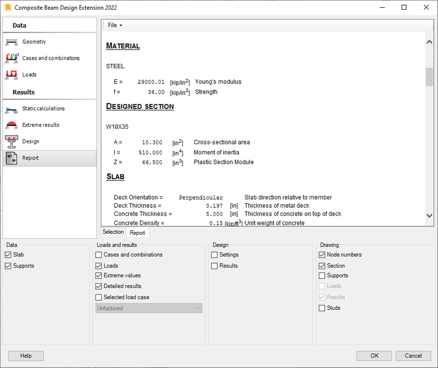

Display design reports in the form of calculation notes.
On the Report tab you can display results for a designed beam in the form of the calculation note.
To view a report, select the Report tab in the graphic viewer. You can select the following data and results to be displayed in a calculation note:
Data
- Slab
- Supports
Loads and results
- Cases and combinations
- Extreme values
- Detailed results
- Selected load case
Design
- Settings
- Results
You can select the following objects to be displayed in a beam drawing in a calculation note:
- Node numbers
- Section
- Supports
- Loads
- Results
- Studs.
To access options allowing you to export, save, or print a note, click File and select:
- Export to Microsoft Word - Sends a note to a Microsoft Word document.
- Export to Microsoft Excel - Sends a note to a Microsoft Excel document.
- Save As - Saves a note as an MHT or HTML file.
- Print - Prints a note.
