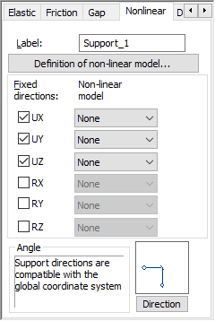

When the Nonlinear tab is selected from the Support Definition dialog, the following dialog displays.
The Label field at the top of the dialog, assigns a label (name) to the support.
Clicking Definition of non-linear model, opens the dialog for defining a curve that specifies the non-linear character of a support. Curves defined in this dialog are visible on selection lists. The non-linear behavior of a support is defined by selecting - for a given degree of freedom - a non-linear model that determines one of the following relationships: force-displacement or moment-rotation. You can select the model when the appropriate direction is blocked.
A diagram of the support being defined is displayed in the lower right of the dialog. Clicking Direction under the digram opens the Support direction dialog, where you can define the direction of the local x axis for the support. The axis is determined by specifying a point, a node, or rotating a support with respect to any axis in the global coordinate system.
Clicking Add, adds the support to the list of active supports.
Clicking Advanced, which is available for nodal and linear supports (it is not available for planar supports), opens a new dialog: Support definition - Advanced
