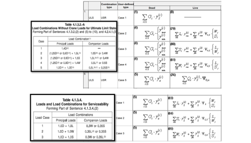

Implemented current load combination standards for the US and Canadian markets.
Load Combination Regional Code Updates
The following load combination standards were implemented:
- IBC 2018
- IBC 2021
- ASCE 7-22
- NBCC 2020
These codes are specified as default in the relevant regional settings.
