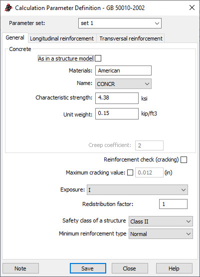

The General tab of the Calculation Parameter Definition dialog box for the Chinese code GB 50010-2002:
Concrete parameters are defined 3 ways.
- When the As in a structure model option is selected, needed material parameters are assigned from the data used for static calculations of structures.
- Define the value of concrete strength Fck.
- Specify from the list of available concrete classes.
Reinforcement check checks the reinforcement due to cracking.
The following parameters may be defined.
- Exposure (the allowable crack width changes depending on which exposure is selected).
- Redistribution factor.
- Safety class of a structure.
- Minimum reinforcement type.
