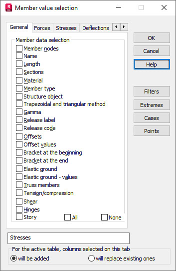

Select the General tab in the Member Value Selection box to select parameters for presentation.
In the Element Data Selection field, the following values may be selected.
  • Element nodes - node numbers defining individual members.
  • Name.
  • Length - member lengths.
  • Sections - member sections.
  • Material - member material.
  • Member type.
  • Structure object.
  • Trapezoidal and triangular method.
  • Gamma angle (for a section).
  • Release label - names of the releases in a structure.
  • Release code - codes of releases in a structure.
  • Offsets - offsets defined for members.
  • Offset values.
  • Brackets at the beginning - brackets at the beginning of members.
  • Brackets at the end - brackets at the end of members.
  • Elastic ground.
  • Elastic ground - values.
  • Truss members.
  • Tension/compression - members working in compression/tension.
  • Shear - members for which the impact of shear forces on structure deformation is considered.
  • Hinges.
  • Story.
Click the All button to select all options available on this tab. Clicking None deselects all options on this tab.
The lower part of the dialog contains two options:
  • Columns will be added - if checked, selected options are added as columns at the end of the active table.
  • Columns will replace existing ones - if checked, selected options replace the current table columns.
