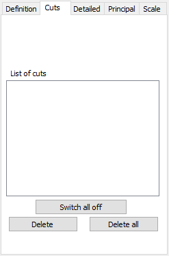

Select the Cuts tab in the Solid Cuts dialog to select displayed cuts.
The List of Cuts field shows all cuts defined for a structure. For each cut, three pieces of information are presented.
- On/off cut presentation for a structure. The cut with maps of a selected quantity is toggled on and off for a structure.
- Color.
- Cut name.
Clicking Apply will offer three more buttons.
- Switch all off. Switches off presentation for all cuts of a structure
- Delete. Deletes a selected cut from the list of cuts.
- Delete all. Deletes all cuts presented on the list of cuts.
