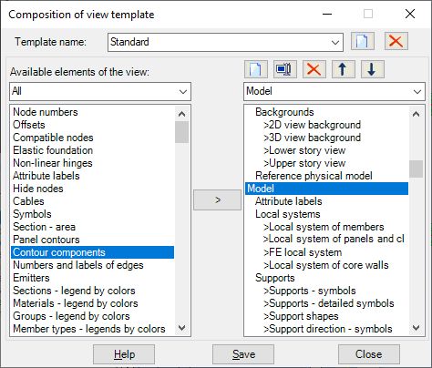

Click
(Configuration) to edit all settings of a template selected on the Template list in the Display dialog.
Click New to begin defining a new template. Note the following changes to the template.
- All objects included in the right panel will be deleted.
- A default template name will be entered.
The two panels in the central part of the dialog define parameters of a new template or modify those of an existing template.
Available elements of the view contains all categories which are indicated in blue in the Display dialog. Click > to move selected categories to the right panel which contains parameters of the currently defined/modified template . A tree display of groups and objects belonging to individual groups is built in the right panel. Elements transferred from the left to the right panel are placed in the group currently highlighted.
While creating a tree of display groups, the following tools are used.
- Creates a group.
- Deletes a main group, a group in blue or a group element (in white)
- Changes the name of a main group (not available for group elements)
- Moves a highlighted element, group, or subgroup up in the list.
- Moves a highlighted element, group, or subgroup down in the list.
A defined template may be saved and made available on the list in the Display dialog.
