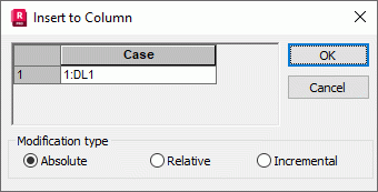

In the load / load case table it is possible to change the numbering of load cases. Select the Case column in the load table, right click and select Fill Special.
This dialog allows changing numbers of load cases when more than one case is selected:
- Absolute - Changes a case number. If several load cases are selected, the entire block of highlighted records is numbered starting at the number entered and each subsequent case number is increased by 1.
- Relative - Adds the value entered to the current number.
- Incremental - Adds incrementally the value entered to the current number.
For example, the available load cases include numbers 1, 3, 5, 6, 7. The cases 5, 6, and 7 should be changed to 2, 3, and 4. To do so, select the records 5, 6, and 7 in the Case column. Right click and select Fill Special. Select the modification type (Absolute) and enter 2. Cases 5, 6, and 7 change to 2,3, and 4. Case 3 will be assigned the first free number outside the block.
