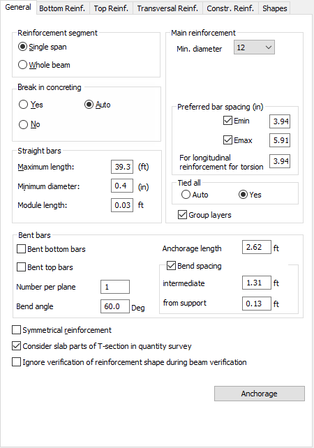

Once the Reinforcement Pattern command is called up and the 'General' tab is selected, a dialog box shown below will appear on the screen.
In the above dialog box, the user may set the general parameters pertaining to the entire beam. These include:
- reinforcement segment - selection of the reinforcement generation method:
- selection of the Single Span option causes the program, to generate the reinforcement span by span
- in the case of selecting the Whole Beam option, the program selects the reinforcement in such a way so that bars be generated in one interval, i.e. that they are extended to all the beam spans.
- upper reinforcement parameters.
For upper reinforcement, the user may:
- define the placement of the bars in relation to each other, if they occur in layers of bundles (in direct contact with each other), or locate the bars to avoid their direct contact.
- define the minimal upper reinforcement diameter
- impose the tying of all main bars (the Tied All option assumes the YES value) by transversal reinforcement. The AUTO setting ties-up the longitudinal reinforcement only if the seismic dispositions have been activated or the generated reinforcement occurs in three or more layers.
- inclusion (or exclusion) of the break in concreting from the calculations.

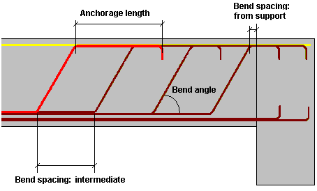

In the lower part of the dialog box there is the Bent bars option. If the option Bent bottom bars or Bent top bars is switched on, then bent bars may be used during calculations of the beam reinforcement. Bent bars will be generated only then if a number of reinforcement layers is greater than one and at least one of the reinforcement layers ends within the span.
The following parameters of bar bends need to be determined:
- it should be selected which bars (bottom or top) should be bent
- number of bends in the plane - it specifies how many bars should be bent simultaneously in one plane
- geometrical values (spacings, angles, etc.) as shown in the drawing below.
If the Consider slab parts of T-section in quantity survey option is switched on, then the volume of concrete necessary to make a beam will be calculated for the T-section of an RC beam; if this option is switched off, the concrete volume will be calculated for the rectangular cross section of an RC beam.
If the Ignore verification of reinforcement shape during structure verification option is switched on, then the code requirements concerning diameters, stirrup shapes, bend angles, etc. will not be checked. This option is used to accelerate structure calculations.
