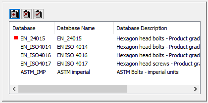

To access the bolts or anchor bolts databases:
- Click
Tools
Job Preferences
Databases.
The Job Preferences dialog opens.
- Select Bolts or Anchor bolts in the left panel of the Job Preferences dialog.
Currently active bolt databases are listed in this dialog. Organize the list with the following tools:
Click this button to add a new bolt database.
Click this button to delete the selected bolt database.
Click this button to set the currently selected database as the default.
