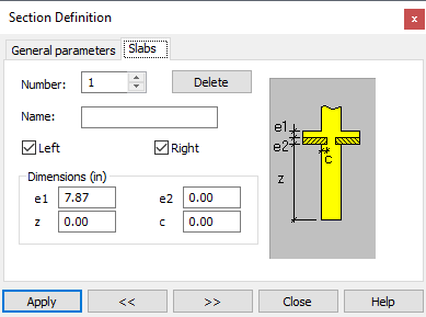

Select the Slabs tab in the Section definition dialog to define parameters for a slab in the deep-beam cross-section.
The following slab parameters can be defined.
- Number.
- Name.
- Position (to the left and/or right of the deep beam).
- Dimensions characteristic as follows.
- e1 - Slab thickness.
- e2 - Thickness of the prefabricated strengthening inset..
- z - Height at which the slab is located.
- c - Support depth.
