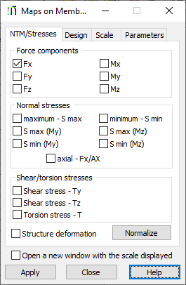

Click Stresses/NTM tab on the Maps on Members dialog, to specify the quantities for which you want diagrams.
You can select diagrams for the following quantities:
- Force components field: FX, FY, FZ, MX, MY, MZ
- Normal stresses field: maximum stresses (from My and Mz), axial FX/AX
- Shear/torsion stresses field: shear stresses TY and TZ, torsion stresses T.
Selecting the Structure Deformation option, displays the deformation of the current structure resulting from the applied load.
Clicking Normalize, displays the diagrams of a selected quantity in such a way that their scales adjust to the maximum and the minimum values of the quantity.
