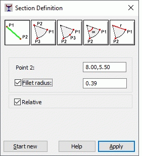

Use this option to define various types of polygons (line, arc) graphically or by typing the coordinates in the appropriate edit fields of the Section Definition dialog.
Access the option by:
  1. Selecting Tools layout > Section Definition.
  2. Clicking Contour menu > Polygon, or clicking on the toolbar.
Note: If a contour is defined by lines, select Fillet radius in order to fillet the contour corners.
If you select Relative and then define a polygon, coordinates of the next vertex are calculated with respect to the position of the preceding vertex. If Relative is cleared, coordinates of polygon vertices are given in the adopted coordinate system.
