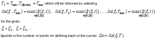

Tp - recorded duration of an earthquake, ω = 2π/T - pulsation for Tmin ≤ T ≤ Tmax, ξ- damping parameter (expressed as a percentage of the critical damping), F(t) - given acceleration diagram.

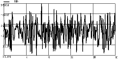

In Figure 1, it is assumed, that the time analysis function F(t) is given. The sequence of Cauchy problems (2) for T = T1 < T2 < … < Tnpoints will be integrated numerically, where

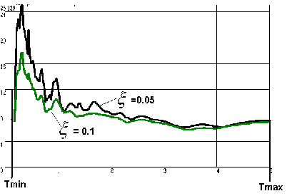

The response spectrum is presented in Figure 2.
Figure 1
Figure 2
