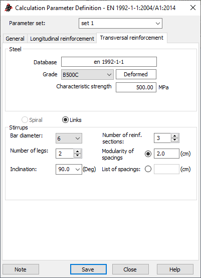

The Transversal reinforcement tab allows you to define the parameters of transversal reinforcement of an RC member according to the Eurocode 2 (EN 1992-1-1:2004/A1:2014 with different National Annexes).

Dialog elements
- Steel
- Select the grade of the defined steel.
- Stirrups
- Defines the parameters of stirrup reinforcement.
- Bar diameter - select the diameter of reinforcing bars for a stirrup. A diameter list in metric units is accessible.
- Number of legs - specify the number of legs of stirrups,
- Inclination - specify the angle between longitudinal and transversal reinforcement; a list of choice contains the following angle values: 90, 65,5 and 45 degrees.
- Number of reinforcement sections - specify the maximum number of sections to which stirrup spacings are assigned. For each section a spacing of stirrups is uniform.
- Modularity of spacings - specify the list of stirrup spacings by modularity value. If a Modularity of spacings is defined as 2" , the accessible spacings are 2,4,6,8 etc., and for Modularity of spacings as 0,5", the accessible spacings are 0.5, 1, 1.5, 2.0...
- List of spacings - specify the list of defined stirrup spacings not linked with any modular value for element reinforcement. For example 1 ,2 ,3 ,6 , and 9.
