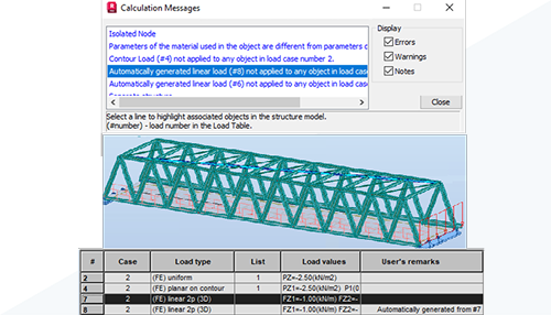

Enhanced messages for loads and performance improvements for loads display have been added.
Enhanced Messages for Loads
Load distribution control capabilities have been improved for communication of load dependence on structural elements and load cases.
  • Added additional details to the load case description in the calculation messages dialog
  • Added explanation of how to identify the load in tables and views
  • Enhanced graphical indication of the selected load
  • Load number exposed in the tables for consistency with calculation messages
  • Detailed information about the origin of the load created automatically
