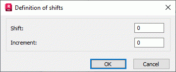

An initial shift value is entered to the Shift edit field. Increment parameter determines the number of iterations performed during modification of the shift. For example, if the increment is 5 and the convergence of an arbitrary eigenvalue is not obtained within 5 iterations, then the shift value will be changed in the manner shown by the following formula.

- If shift = 0 and increment ≥ 0, then the initial shift value equals zero
- If shift ≥ 0 and increment = 0, then the shift value is constant during all subspace iterations
- If shift = 0 and increment = 0, then the shift is not considered and Kσ = K.
Dynamic problems - remarks
You can use a variable shift value (when the increment value is greater than or equal to zero) to accelerate convergence. A shift value will be changing as shown by the equation (2). This method of calculations is recommended when convergence is slow. However, it should be remembered, that each change in a shift value causes repeated factorization of Kσ matrix; therefore, a shift value should not be modified too often.
Application of a constant shift value (when increment = 0) changes position of the convergence center to the value of the assumed shift σ.
Buckling problems - remarks
For buckling problems, only positive eigenvalues are taken into account. A positive value of the initial shift may accelerate convergence considerably. If a variable shift value is assumed (increment ≥ 0), then modification of a shift value takes place only when the updated shift value is greater.
