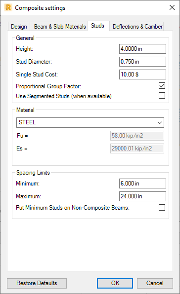

Stud settings
  • Height.
    Specifies a stud height.
  • Stud diameter.
    Specifies a stud diameter.
  • Single stud cost.
    Cost of each stud used in calculation of the beam cost and in cost optimization.
  • Proportional Group Factor
    When enabled, it allows interpolation of group factors between code-supplied values when more than one row of studs is required only along part of a beam length.
  • Use segmented studs (when available)
    Select this setting to use segmented stud distribution for girders, saved in Robot. See Design Assumptions - Studs. Segmented distributions are saved as a comma-delimited list, ordered from the start point of an analytical beam.
  • Material
    Specifies steel used for studs, steel strength (Fu) and Young's modulus (Es). You can select:
    • Custom, for user-defined material. Then accept default or specify your values of Fu and Es.
    • Database material.
  • Minimum and maximum spacing limits.
    Specifies the minimum and maximum allowable spacing for studs.
  • Put Minimum studs on Non-Composite Beams.
    Select this option to add studs for the beam designed as non-composite (using the Design Non-Composite procedure).
