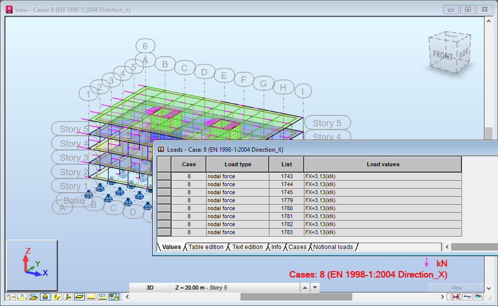

Contrarily to a static analysis, loads in a simplified seismic analysis are not set by the user directly; they are calculated by the software. The user defines parameters based on the local building code. Then, the software calculates the seismic loads and applies them to the structure. This prepares the model so the standard static analysis for internal forces and deformation calculations can be performed.
This tutorial guides you through the following tasks:
- Create a new seismic analysis using Equivalent Lateral Force load cases.
- Display these loads graphically, in a table, and using the Calculation notes.

- Set up the Seismic Analysis. Learn how to modify the display to show the stories by color and how to create a new analysis type for linear static analysis.
- Run and review the analysis. Learn how to display the seismic loads graphically, in a table, and using the Calculation notes.
