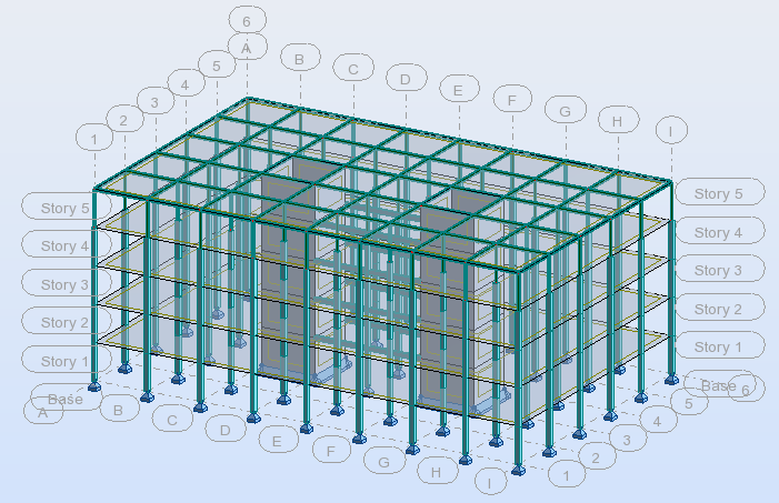

Create a Structural Model
In this tutorial, you learn how to create a structural axis and stories on which you define your structure.
This tutorial guides you through the following tasks.
- Add columns, beams, walls, and a floor with openings for the shafts.
- Copy elements to other stories.
- Change the columns of the top floor from reinforced concrete to steel.
- Add beams from column to column.
This tutorial should take about 30 minutes.
The final version of the structure is shown below.
Click here to start this tutorial.
