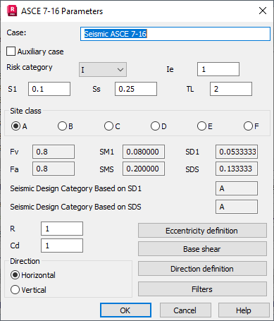

Select the US seismic code IBC 2009 (International Building Code 2009), IBC 2012 (International Building Code 2012) or ASCE 7 (Minimum Design Loads and Associated Criteria for Buildings and Other Structures) in the New Case Definition dialog or click Parameters in the Analysis Types dialog.
To complete the seismic analysis according to the rules given in this code, define the following parameters.
  • Site class (A, B, C, D, E or F) based on the site soil properties, classified according to Chapter 20 of ASCE 7.
  • Spectral response accelerations, as specified in ASCE 7-10 Section 1613.3.1, shown in Figures 1613.3.1(1) through 1613.3.1(6) or ASCE 7-16 Section 11.4.4:
    • S1 - Acceleration parameter for 1-second period determined according to Chapter 22 of ASCE 7
    • Ss - Acceleration parameter for short periods determined according to Chapter 22 of ASCE 7.
  • TL - Long-period transition period, specified according to Chapter 22 of ASCE 7.
  • Parameters I and R, used to scale the response spectrum and calculate seismic Base Shear as specified in ASCE 7 Section 12.8:
    • Ie - Importance factor, as specified in ASCE 7, Section 11.5.1.
    • R - Response modification coefficient, as specified in ASCE 7, Tables 12.2-1,
The site coefficients Fa and Fv are interpolated based on the parameters S1 and SS.
Design Spectral Acceleration Parameters are calculated from the following equations:
Click Eccentricity Definition to open the Definition of mass eccentricities dialog where you can specify how to account for the eccentricity of a mass in the seismic analysis.
Click Base Shear to open the Base shear dialog. There you can select how to take account of the base shear force: calculate it according to the provisions of the seismic code ASCE 7-05 Section 12.8 or specify it.
In the lower part of the dialog, the Direction definition and Filters buttons are located.
The details concerning this structure analysis method can be found in the mentioned code.
