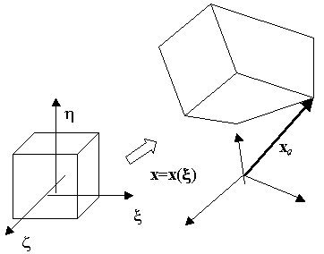

  • Element geometry
    Element geometry is based on isoparametric mapping from a reference element onto an arbitrary element

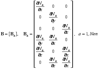

  • Strain evaluation
    Where B matrices are defined as:
    Shape function derivatives in B matrix elements are defined as:

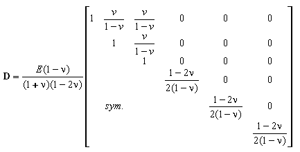

  • Stresses (elastic case)
    Where e o are imposed strains (thermal dilatation and shrinkage) and D is a constitutive matrix. The constitutive matrix D (linear - elastic isotropic material) is shown as follows:
