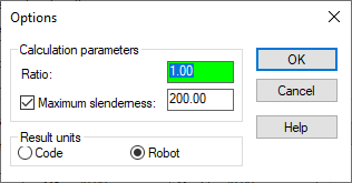

Use this dialog to set parameters for steel member verification. Access the dialog by clicking the Options button in the Manual Verification dialog. The following dialog displays:
Two calculation parameters are defined:
  • Efficiency Ratio - indicates the coefficient for calculations of the yield point;
  • Maximum Slenderness - if this option is selected, member slenderness is verified. Additionally, the admissible (maximum) slenderness value can be specified there.
Member design results are displayed in either selected steel code units or in the Robot units.
