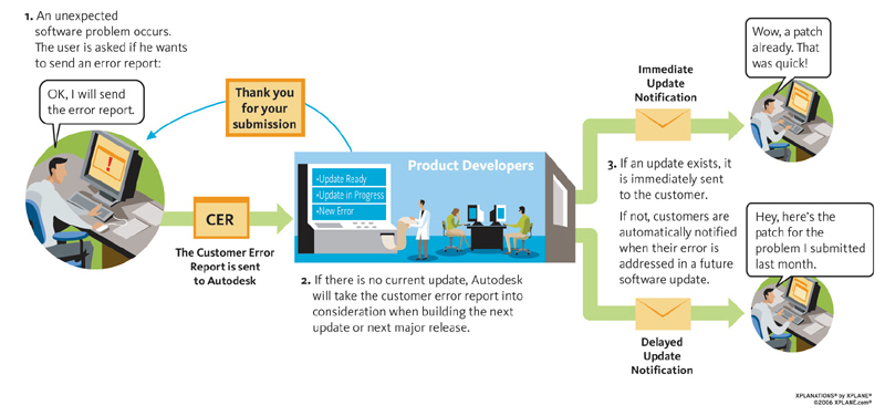

Error Report Workflow Diagram
This diagram provides an overview of how CER works:
How Error Reporting works
The CER dialog box appears whenever an Autodesk product closes unexpectedly. If you choose to send an error report to Autodesk, the error report feature records the portion of program that was in use when the error occurred, the recent command history, and basic system information. In addition, you can include your email address and a step-by-step description in the report. The error report is sent to Autodesk over a secure internet connection.
When Autodesk receives error reports, automated systems sort the reports so that Autodesk developers can review them. Reports are then analyzed and errors are prioritized based on their severity and the number of customers affected by a problem.
Once a software error is believed to be fixed, it is included in either a future maintenance update or the next release of the product. Autodesk also notifies those customers who initially reported the error and included their email address in the error report.
